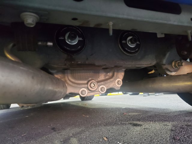

Installed the inserts and did have increased NVH but found it was caused by worn pinion bearing that was not noticeable with the un-reinforced/soft OEM bushings. This is an issue found by several individuals who installed the JXB. Not the fault of JXB! Great product and easy install! Highly recomended.

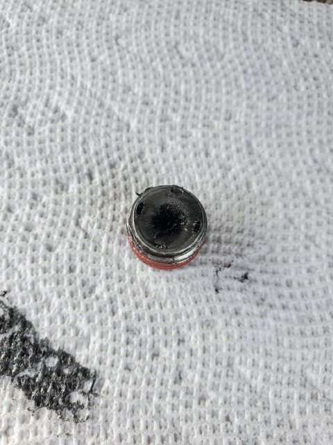

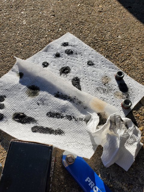

After my JXB insert install I noticed a whine, almost grinding sound on deceleration. I replaced my rear end with a low milage unit and the nose went away immediately. I drained the fluid of the old diff and saw a ton of gold flake. I'm sure the diff was eating the pinion bearing and it wasn't noticeable until the inserts were installed.

I found my rear center section was the culprit by changing the fluid. The magnetic drain plugs were full of sparkle sludge. Not sure what component(s) went bad. I've since replaced the center section with a low milage salvage unit from an aviator and went back to OEM pinion bushings (I read several posts about the Steeda pinion bushings breaking at the flange). The noise has gone away. The next issue is the shop that replaced my center section didn't use the right tool to remove the driveshaft and bent up the driveshaft flange where it meets the pinion. SMH
